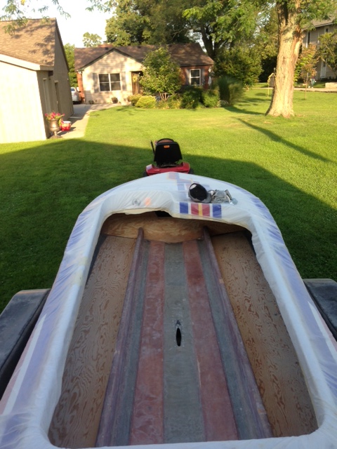

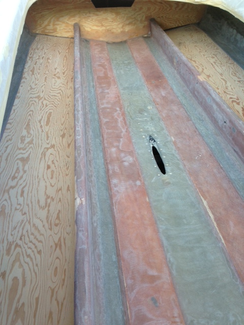

    After we got it home and took a good look at it we decided all the hardware needed to come out and replaced, it was all well worn after it's racing career. Also decided that the floors needed to be refinished, found some delam on the stringers in spots plus the floors just looked bad so I started grinding fiberglass.....
    Name:  Boat Floor1.jpg
Size:  145.1 KBName:  Boat Floor3.jpg
    What a horrible job and I will never do this again - much of the summer of 2013 was spent being very itchy from fiberglass dust.
    The original wood looked good after all the grinding, too bad I made a few rookie mistakes and ground through the top layer of it in a few spots. So I laminated down a layer of end-grain balsa and got some epoxy / cloth back over the floor by late fall. I went with epoxy because it's easier to work with, doesn't stink and is supposed to perform very well.

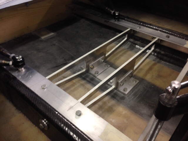

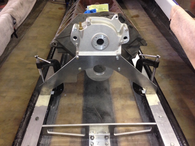

    After the epoxy cured I started finish sanding in preparation for flow coating, I decided that I should start fabbing the new hardware before the final flow coat so I wouldn't have to worry about scratching it.
Size:  103.8 KBName:  image.jpg
Size:  84.0 KB[ATTACH=CONFIG]
    As you can see, everything is going to be new.

Size:  73.0 KBA few more hardware pics..
    At this point we're done fabbing and getting back on finishing the floors - more updates as soon as I have them.

    Very nice work... AND FORD POWER!!! TELL ME MORE, please...
    Thank you. The engine is 525ci, pump gas, 10:1 compression. Ford Super Cobra Jet aluminum heads with a quick fuel 1050 carb. I had it in my 96 Mustang last year that went 9.82 at 139 foot braking so it makes decent power (about 630), I want to try a little bigger cam and a different intake for the boat to see if it will make a little more power. Really hope to run 10 ohs on pump gas, we'll see?

    I just noticed the riding mower is your tow vehicle in this shot. Nice!!
