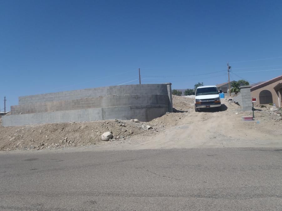

    first thing I did was grade the lot, I built the stack retaining wall across the back my self... had masonry and more do the cinder block walls

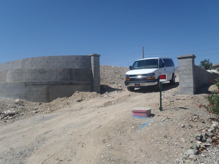

    I have the driveway graded, the rear and front retaining walls....

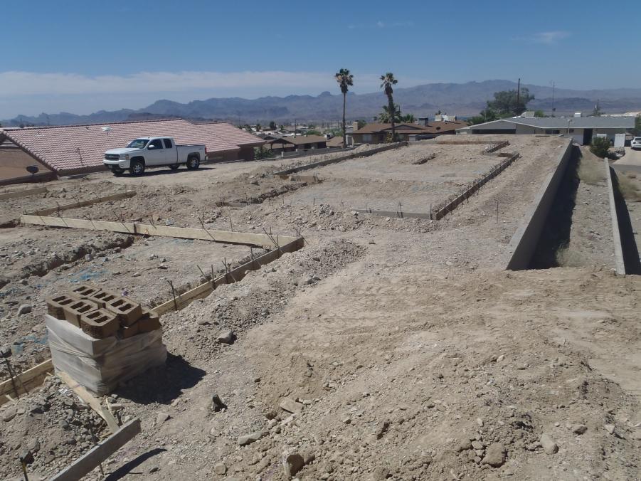

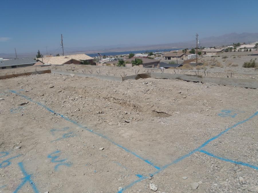

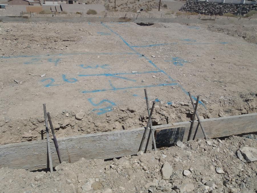

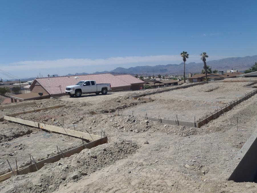

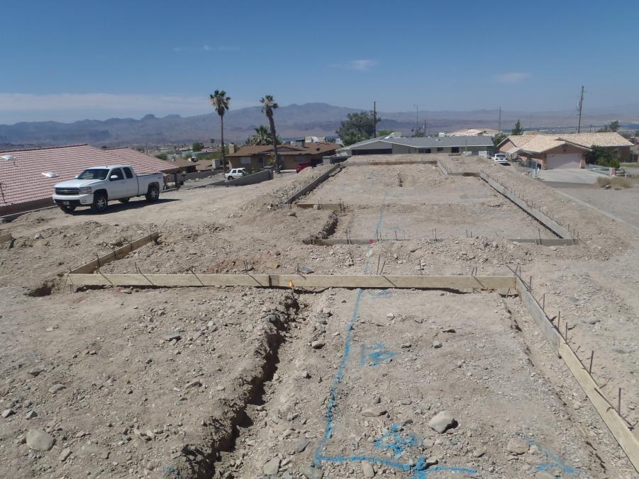

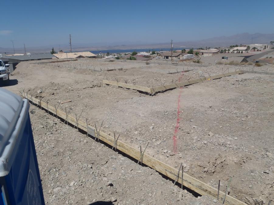

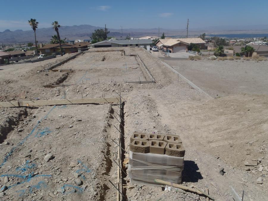

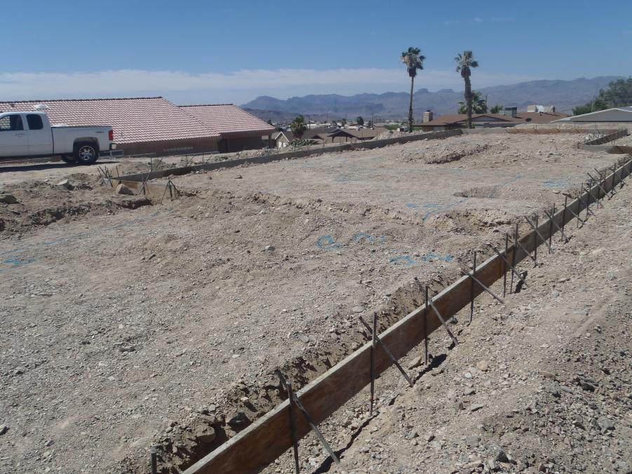

    so the next thing is to trench for under ground power ,water and sewer, followed by forms (RAILS) for the footings and slabName:  lot 001.jpg
Size:  85.2 KBName:  lot 002.jpg
Size:  68.9 KBName:  lot 003.jpg
Size:  67.7 KBName:  lot 008.jpg
Size:  100.7 KBName:  lot 035.jpg
Size:  102.5 KBName:  lot 037.jpg
Size:  118.3 KBName:  lot 039.jpg
Size:  111.3 KBName:  lot 040.jpg
Size:  114.5 KBName:  lot 041.jpg
Size:  119.7 KBName:  lot 042.jpg
Size:  108.4 KBName:  lot 043.jpg
Size:  137.8 KBName:  lot 044.jpg
Size:  92.2 KBName:  lot 045.jpg
Size:  89.1 KBName:  lot 049.jpg
Size:  74.5 KBName:  lot 050.jpg
Size:  115.6 KBName:  lot 053.jpg
Size:  126.0 KBName:  lot 062.jpg
Size:  128.3 KBName:  lot 063.jpg

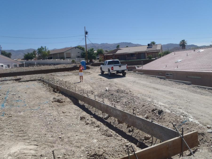

    ok, so the slab is done...Name:  cheetah havi lot 010.jpg
Size:  96.3 KBName:  cheetah havi lot 011.jpg
Size:  72.5 KBName:  cheetah havi lot 012.jpg
Size:  54.8 KBName:  cheetah havi lot 013.jpg
Size:  53.3 KBName:  cheetah havi lot 014.jpg
Size:  68.8 KBName:  cheetah havi lot 015.jpg
Size:  100.1 KBName:  cheetah havi lot 016.jpg
Size:  107.2 KBName:  cheetah havi lot 017.jpg
    the power is under ground, as is the sewer and water line from house to detached
