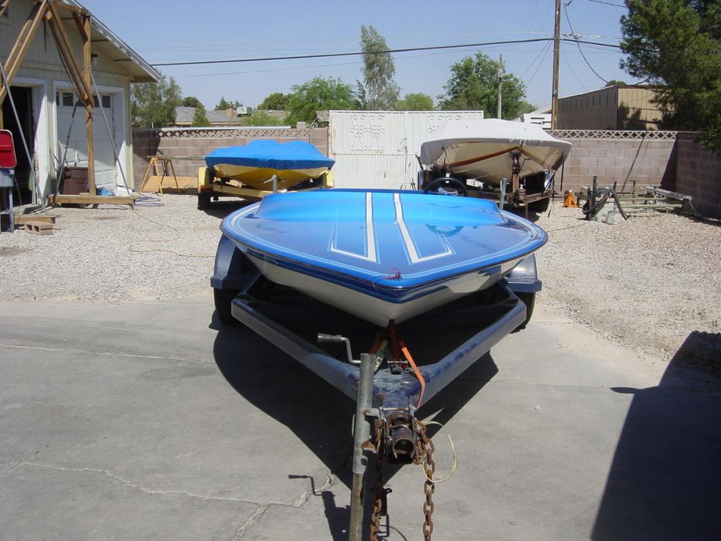

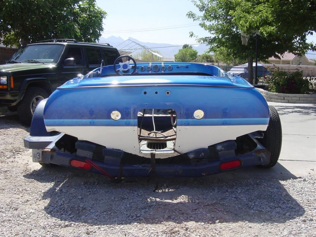

    So here it goes. The wife and I hauled ass up, from Vegas, to Jasons shop, Roke Trailers, in California and picked the thing up and drug it back home.

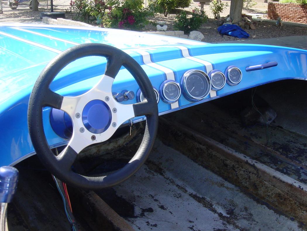

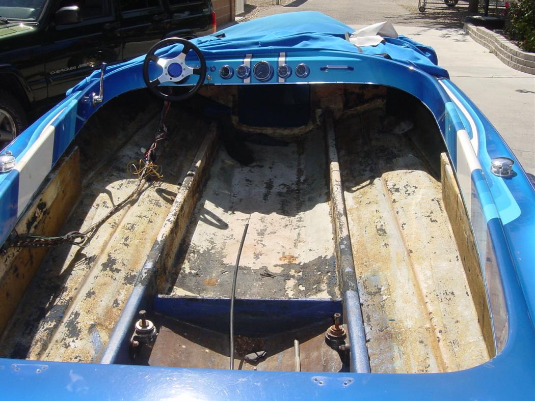

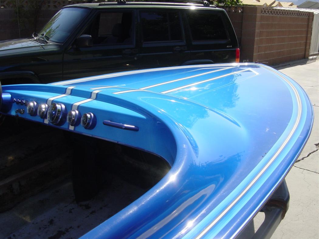

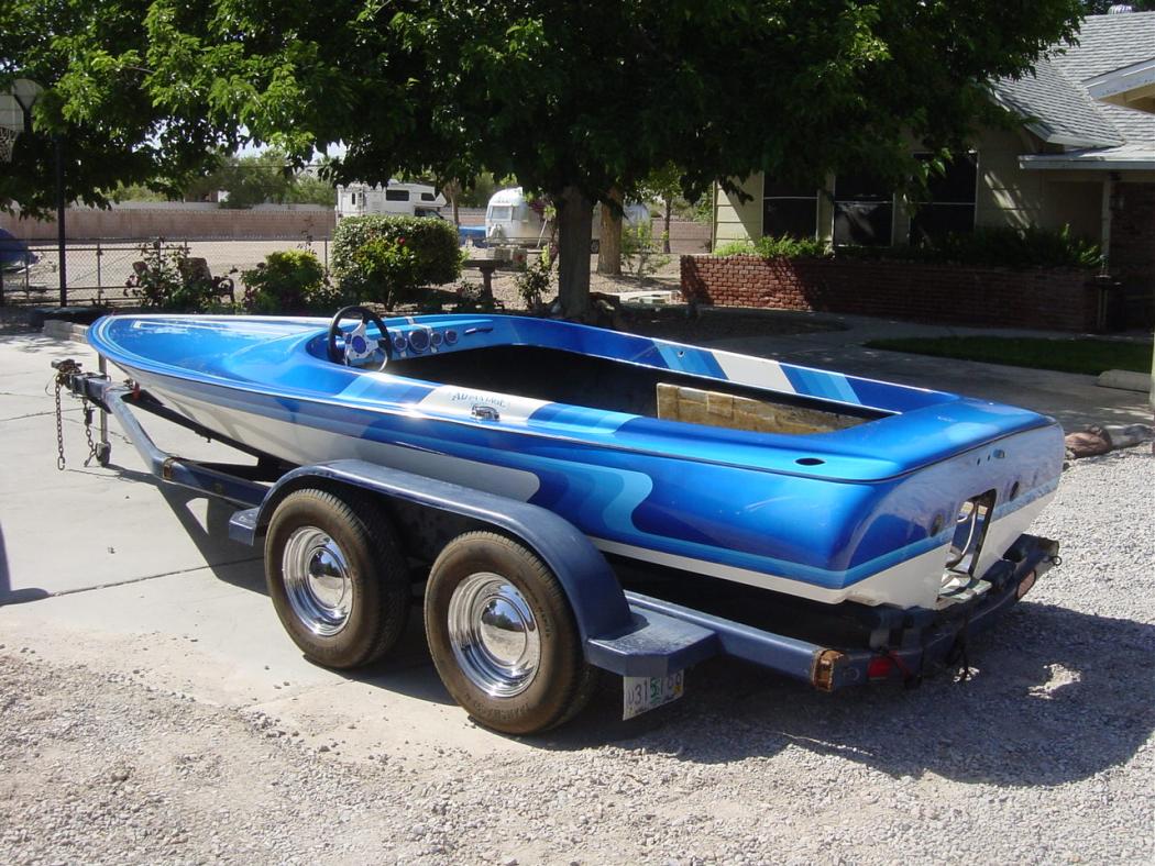

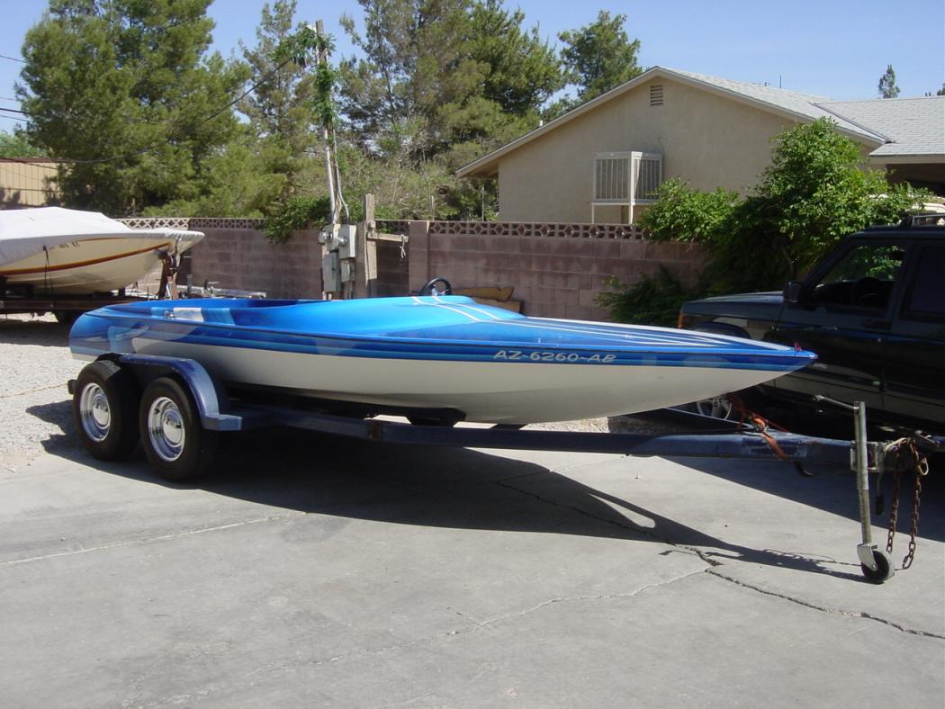

    The good. It is the hull that I wanted, The gel is in pretty dam good shape, the stringers and floor are in good shape and seem to be solid, and it has a pretty straight and solid Competitive tandem axel trailer, under it.
    The Bad. On the transom, there is a sun faded spot that has faded thru to the base, there are hardware holes all over and one of the fiberglass fenders has been blown out. Sounds like fun right!
    Here are a few pics from when we got it home.
    The good!

    Ok so for the bad. The faded spot and the holes that I will have to do some creative covering on.

    The trailer did not fit this hull, so I had to rebunk the trailer. I had to cut off the old bunk brackets, and fabricate new ones and re weld them in the proper position.
