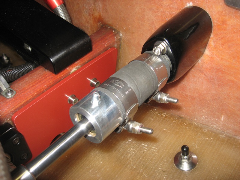

    I made up some new 1" prop shaft log seals. They are made from 6061-T6 aluminum with a machined finish. They are 2 1/2" diameter by 2 1/2" long. There is a pressed in 2" dia. double sealed bearing with the inside diameter bored to 1.002" (to slip over your prop shaft) its also held in by a snap ring for safety.
    Inside there is a double lip cup seal to keep the water out and a grease zert on the outside body to grease the seal. A standard size 1 3/4" hose fits from the rear, I also added rounded grooves to help the hose clamp bite into the housing and not slip off.
    With this design there will be no more prop shaft wear of bushings to replace because it rides on a bearing.
    I'm selling these for $89.00 . Let me know if you would like one. I am also have 1 1/8" diameter prop shafts seals if your interested. Thanks, Phil
