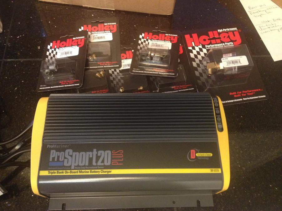

    I have this 3 bank maintainer/charger installed in my Boat. I have 2 grp 27's and 1 grp 24 that it maintains all independently. The Boat is plugged into it all the time it's not on the water, and so far so good.
    Name:  2013-06-12 19.38.41.jpg

    I have to agree with Hotboat. Any charger that does a Constant Trickle charge is not good for the battery, it can boil a battery. If you want an inboard charger do what 28elim. did, that charger shuts completely off when the batteries are at full charge. I would leave it plugged in for a couple days and then unplug it and would do that every couple weeks. Kinda makes be nervous to leave it plugged in all the time but thats just me.

    This one stated it shuts off after its full. Is that not the case?
